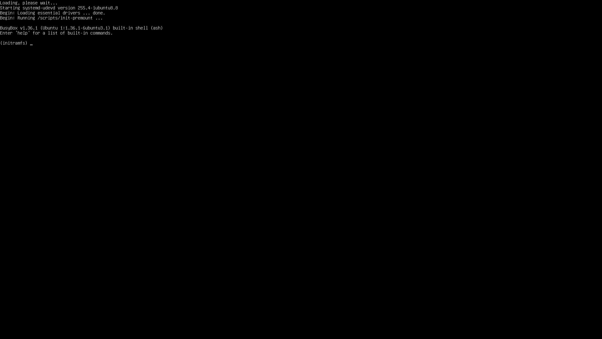

  4. Hello, I try to use armbian image on SD card for my nanopi r6c, it is without emmc, can only boot with SD card. However, armbian can't boot correctly. It stop at pre-mount while booting up, please refer to attached screenshot. I tried the images that can download from armbian web site and build armbians image with my PC, none of them can work, all are same issue, but Dietpi image for r6c can boot successfully. Images tried, but not work: #download from armbian site Armbian_25.5.1_Nanopi-r6s_noble_vendor_6.1.115_gnome_desktop.img Armbian_25.5.1_Nanopi-r6s_bookworm_current_6.12.30_cinnamon-backported-mesa_desktop.img Armbian_25.5.1_Nanopi-r6s_noble_current_6.12.30_gnome_desktop.img Armbian_25.5.1_Nanopi-r6s_noble_current_6.12.30_kde-neon_desktop.img #build by compile.sh Armbian-unofficial_25.08.0-trunk_Nanopi-r6c_noble_current_6.12.33_gnome_desktop.img Armbian-unofficial_25.08.0-trunk_Nanopi-r6c_noble_edge_6.15.2_gnome_desktop.img Armbian-unofficial_25.08.0-trunk_Nanopi-r6c_bookworm_edge_6.15.2_cinnamon-backported-mesa_desktop.img Image can work: DietPi_NanoPiR6C-ARMv8-Bookworm.img Please help on this issue. Thanks.
  5. Check here https://github.com/armbian/community/releases/tag/25.5.0-trunk.256 or on a mirror with archive https://docs.armbian.com/Mirrors/#current-mirrors for what you are looking for. We're aware that some links are broken for yet to be determined reason.
