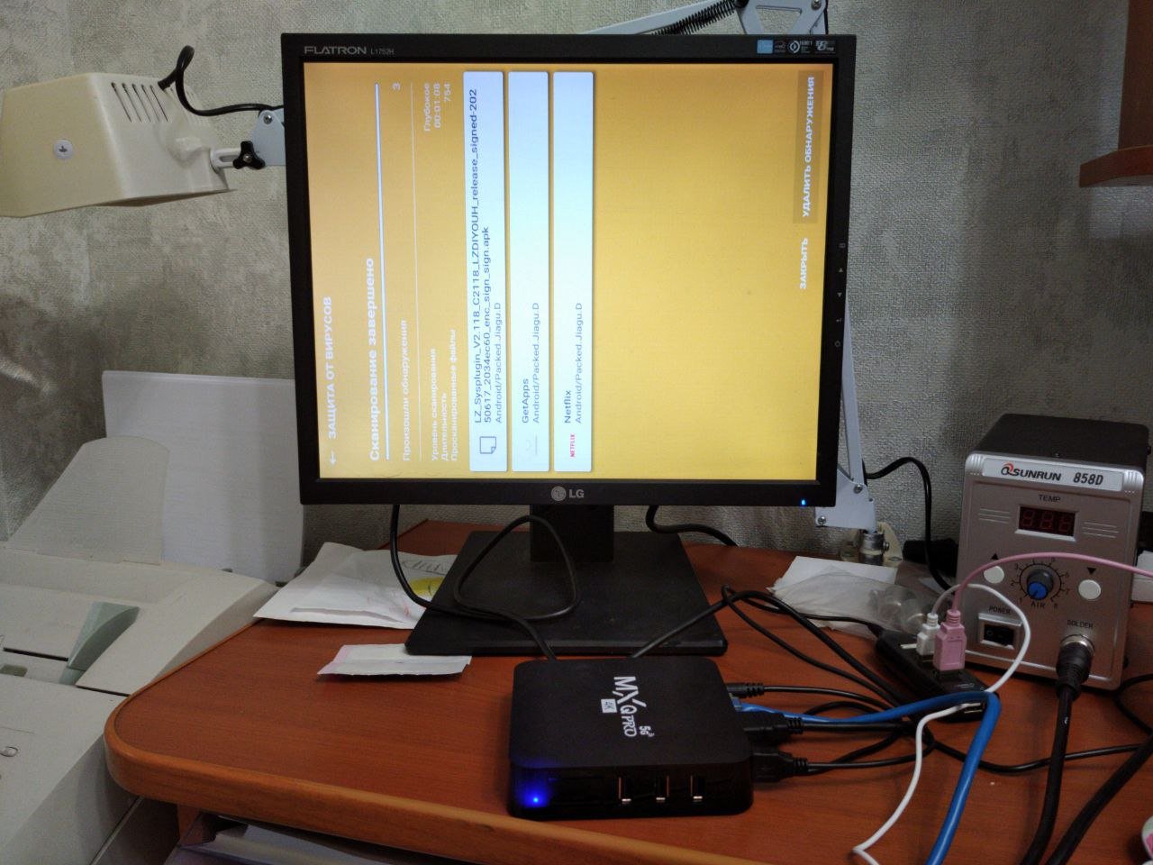

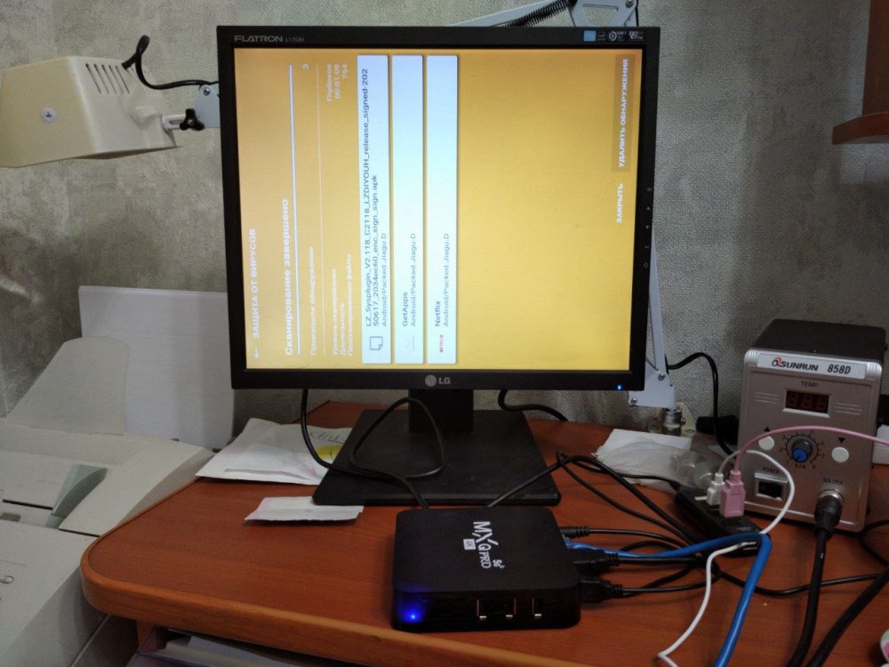

  2. So i have found what's we dealing with: it is HiSilicon hi3798mv310. See attached proc_version and config.gz. Furthermore, I've installed eset nod32 antivirus on this box and it found some suspicious apps (see photo). I will send them to eset for more thorough analysis. Overall this news is "Not great, not terrible". @Ducdanh Nguyen, I think there is no pre-built armbian or other linux distro images for this chip. I did a brief google search and found only this SDK: https://github.com/JasonFreeLab/HiSTBLinuxV100R005C00SPC050 As it seems to me, you can compile it and get some clean linux for this box. Let us know if it works. BTW, author of this SDK recommend to burn it using HiTool. But HiTool uses UART (only?) to interact with chip, and we don't have UART wired on our board. There are seems to be option to upgrade it from usb flash, but how will this work - idk... Also, here is related discussion: What about debugging by usb - either through enabling Android "Debug over usb" function or booting with reset button pushed - I doubt it will work. Nevertheless, this tv box is usable for its direct purpose. All that should be done, is replacing heatsink and changing firmware to trusted one (without any trojans and viruses). BTW, funny fact: hi3798mv310 have only 3 USB interfaces, but on our board there are 4 USB connectors. LOL! I'm wondering if there any scam museum in the world? If any, this box will be a very interesting piece for them. config.gz proc_version
