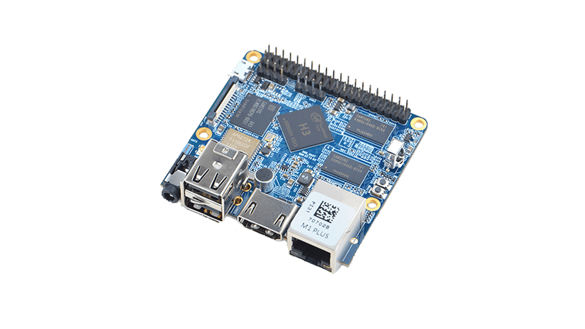

Ali-leb Posted November 1, 2019 Posted November 1, 2019 trying to know what is the chipset used for wifi in M1+ but it is not mentioned in hardware specs at wiki.friendlyarm.com ! .... with its datasheet. thanks in advance
Igor Posted November 1, 2019 Posted November 1, 2019 broadcom ap6212a like on most of the others. You can see it on the photo: 1
guidol Posted November 1, 2019 Posted November 1, 2019 another picture from the Wiki page http://wiki.friendlyarm.com/wiki/index.php/NanoPi_M1_Plus and the pdf: http://wiki.friendlyarm.com/wiki/images/5/57/AP6212_V1.1_09022014.pdf 1
sfx2000 Posted November 6, 2019 Posted November 6, 2019 On 11/1/2019 at 1:31 AM, Ali-leb said: trying to know what is the chipset used for wifi in M1+ Broadcom BCM43438 Wi-Fi 802.11n (2.4GHz only) + Bluetooth 4.1 (Dual Mode) combo chip 1
