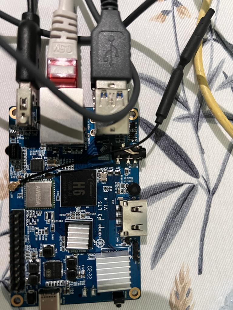

January 25, 20233 yr Hello @Igor Thank you for you reply. I will try your suggestion. My version is the OrangePi 3 LTS (see photo attached)
January 26, 20233 yr 13 hours ago, Paulo12333 said: Doesn't work This is crazy. I have several Opi3 and they all work, while people reporting "WiFi doesn't work". Please provide everything what you did, which image you are using, how do you trying to connect and provide full logs.
