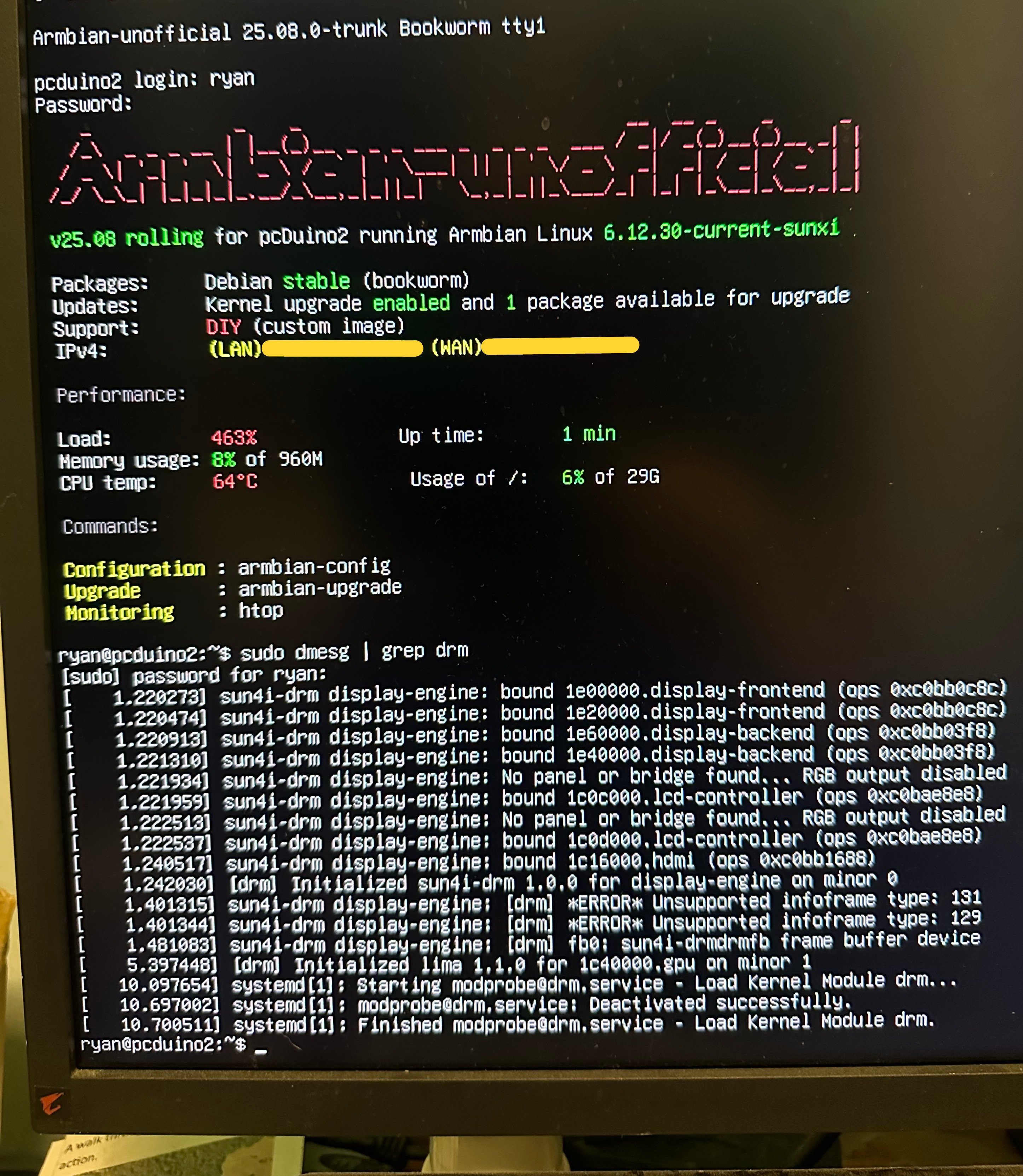

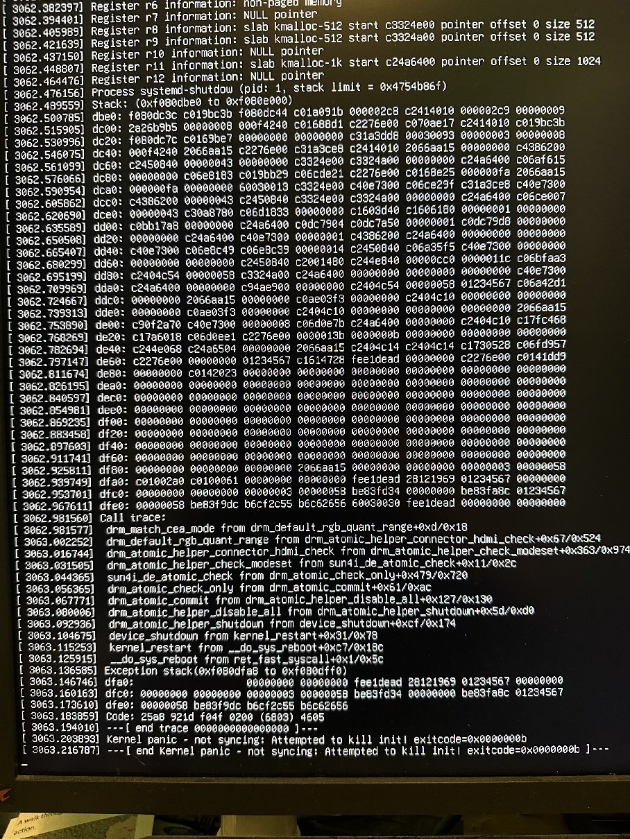

  2. The good news is that we get a working display. The bad news is that it creates a new problem. when Either shutting down or rebooting a kernel panic is triggered. After a bit more digging I found the reason that the drm_hdmi_connector_mode_valid patch failed is because the function does not exist under kernel 6.12. I dont know yet if it may be necessary to include it yet or if drm_atomic_helper_connector_hdmi_check needs some further tweaks. Thanks Ryzer
