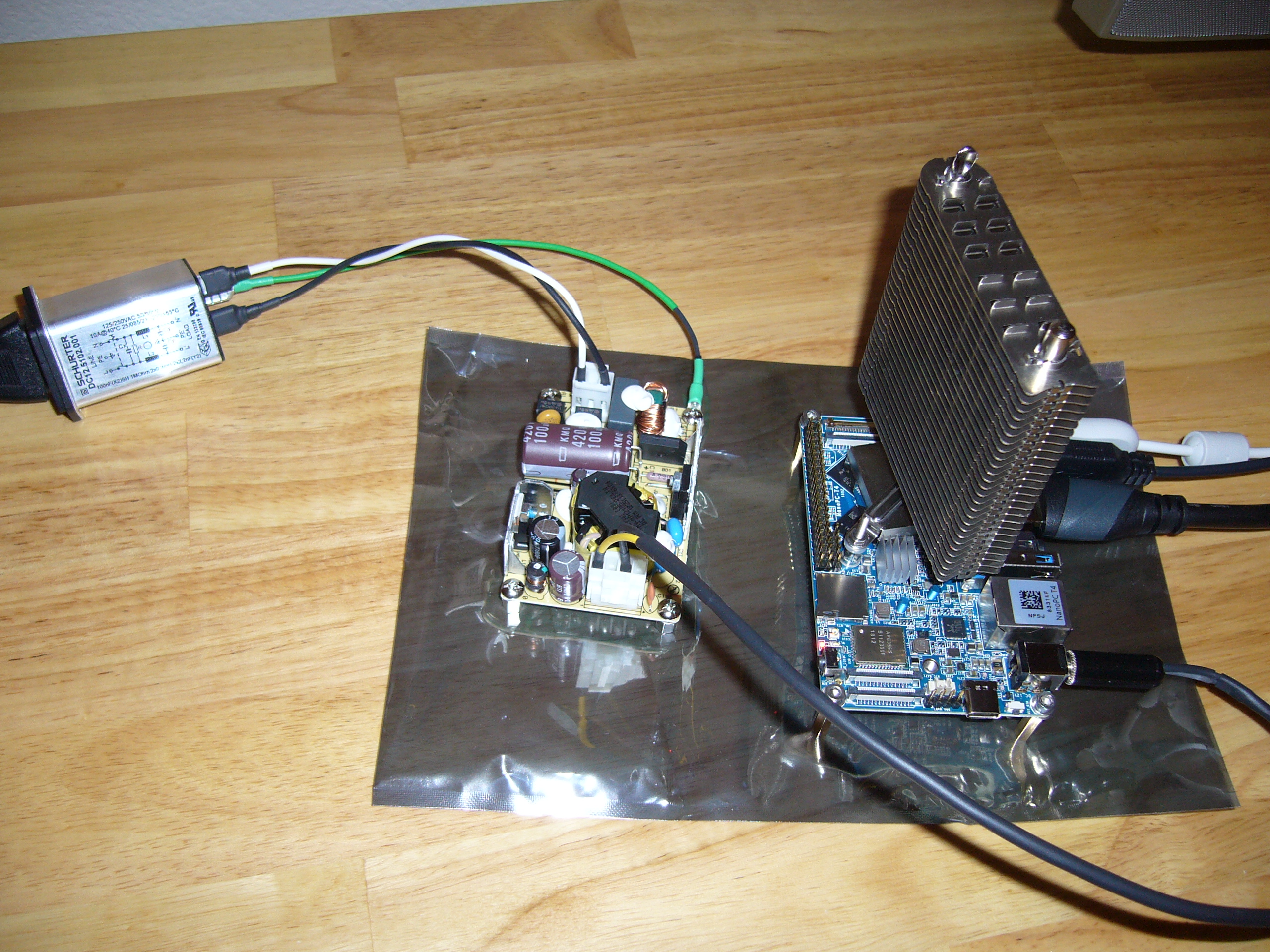

Well, tried the same with your overclocked settings on NanoPC-T4 but this definitely kills the board.
I tried it several times without a fan and just the passive heatsink and the board powered down always when running the multi-threaded 7-zip test.
Then added a large fan blowing directly over the heatsink and now cpu-miner kills the board:

Write failed: Broken pipe

Finally fired up my NanoPC-T4. Reading this thread, I figured it had thermal limits in either the power components or the RK3399, so I stuck heat sinks on some of the power components (the Silergy 837/838 and the main 3.3V regulator, and the RK808) and an old Thermalright HR-05 (single heat pipe with a fin stack about the size of the board) on the RK3399. The power components seem to run OK, but it's fairly easy to push the RK3399 +45..50C ("openssl speed -multi 6") in an 18C room (no air flow) (the CPU thermal sensor seems fairly accurate). So the RK3399's over-temp signal (NanoPC-T4 schematic, sheet 13) is likely the source of the shutdown issue when overclocking. A couple things:
- 6W TDP? At 2.0/1.5, I'd guess higher - maybe 10W. Higher than an N3150 Atom (not comparing anything other than TDP).
- Is there a way to clock the thing up without compiling a new kernel?
- Probably the wrong thread, but has anyone set up to boot from an NVME SSD? I firgure I'll try it, as soon as I wrangle a USB cable (to cheesily update the U-Boot "parameter.txt" on the eMMC, something I could probably do from the console or via dd, but hey).
- Gluing tiny pieces of aluminum to tiny chips is a pain. And the giant fin stack somewhat defeats the purpose of the tiny board, assuming one cares more about board size than the burning weenie-roasting SOC. Me, I'd prefer Mini-ITX.
- Photo of the silly thing (warning: 2MB JPG): http://www.tailbone.net/p1000322.jpg
